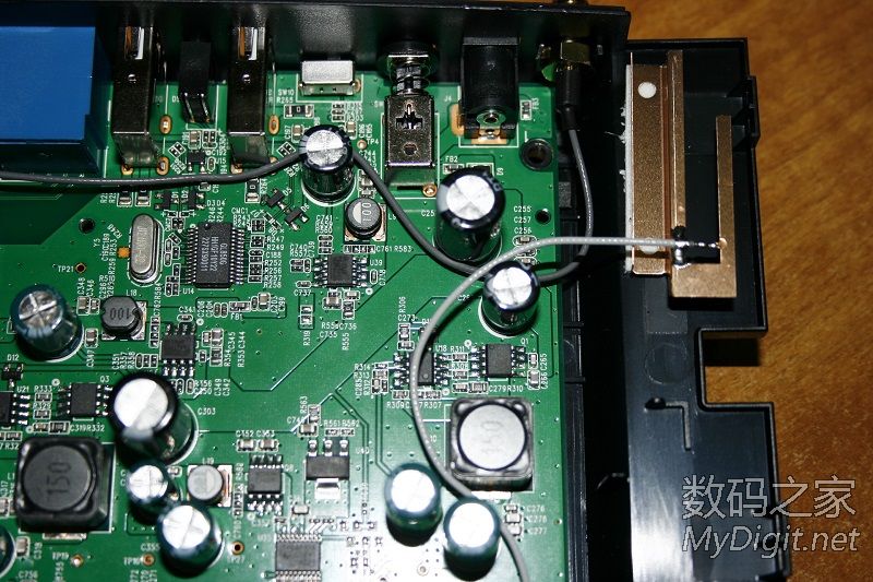

转 tp-link wdr4900 出口版本 路由拆机
发表于 2013-5-15 22:41 | 显示全部楼层 |阅读模式
图片来源国外
不急不急慢慢看     {:soso__3940829679135332815_7:}
TP-LINK TL-WDR4900 v1
(Est.) release date: 2013
Country of manuf.: China
Type: wireless router
FCC ID: TE7WDR4900
Industry Canada ID: 8853A-WDR4900
Power: 12 VDC, 2.5 A
Connector type: Barrel plug
CPU1: Freescale Semiconductor P1014(800 MHz)
FLA1: 16 MB (Spansion FL128SAIF00)
RAM1: 128 MB (Hynix H5TQ1G63DFR-H9C)
Expansion IF types: USB 2.0
USB ports: 2
WI1 chip1: Atheros AR9580
WI1 802dot11 protocols: an
WI1 MIMO status: 3x3:3
WI1 antenna connector: RP-SMA
WI2 chip1: Atheros AR9381
WI2 802dot11 protocols: bgn
WI2 MIMO status: 3x3:3
WI2 antenna connector: none
ETH chip1: Freescale Semiconductor P1014
Switch: Atheros AR8327N
LAN speed: 10/100/1000
LAN ports: 4
WAN ports: 1
abgn
Third party firmware supported: OpenWrt, DD-WRT
Default IP address: 192.168.0.1
Default login user: admin
Default login password: admin

图不给力啊,看不到Chip信息么

掉链了好像

确实不给力,图片出来好慢,还不全
是我网络问题么

为啥出口的做工这么好呀!因为价格贵?唉。。
